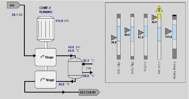

Moving Analog Indicators
A moving analog indicator
These components display an analog value in context with other information about that value. The current value is shown as an arrow pointing at a bar with segments that show the desired operating range, low and high alarm ranges, and interlock ranges.
By looking at a moving analog indicator, the operator can see at a glance if the value is in its normal range or if it needs attention. If the value is in an alarm range, then that range changes color.

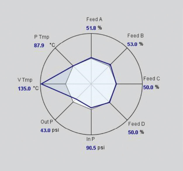

Radar Charts
a radar chart
Also known as web charts, spider charts, or spider plots, these circular charts display several values at a glance. At a glance, it can show the operator whether a process is running on-spec or off-spec.
In a radar chart, each value is plotted like a spoke on a wheel. Inside the wheel are two shapes: one shape is formed by a line between the current values, and the other shape represents how all the values would look if they were in their desired range.
In the chart below, you can easily see which values are running outside their desired ranges.

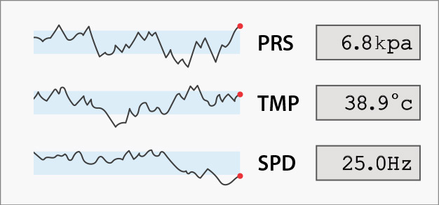

Sparkline Charts
a sparkline chart
In Ignition, embedded trends are called sparkline charts. A sparkline chart is a minimalistic chart component that displays a line-chart history for a single data point. It shows a great deal of contextual information in a very small amount of space.
By binding the property of a sparkline chart component to a SQL query or a tag history, the operator can see what the value has been over the last few minutes or hours. For example, by placing a sparkline chart next to or on top of a tank component, you can track whether the tank’s temperature is rising, falling, or oscillating.

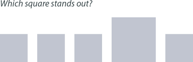

3.1: Size
which square stands out
This is easy to see because the larger square is clearly different from the others, so it draws our attention. This is because the human eye is incredibly attuned to finding patterns, and anything that breaks a pattern will immediately draw our attention. In this case, all the squares are the same size, except one; therefore, the larger square has more emphasis than the others.
Applying this to an HMI project can be very straightforward: the larger the element on the screen, the more attention it will command. This only works if the size difference is relative to other elements on the screen. If all the elements on a screen are large, none of them will have emphasis over the others.

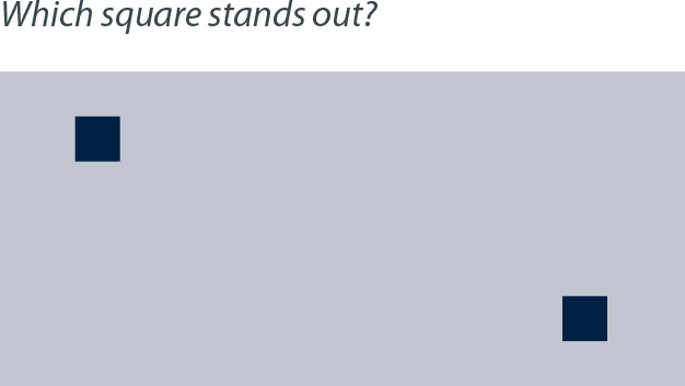

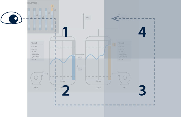

3.3: Position
Which square stands out?
The average viewer tends to say the square on the top left. This is because in Western cultures, people typically read from top to bottom and left to right, and as a result our eyes are trained to move across a page in a certain way. You can take advantage of this by placing elements you want to emphasize in places that our eyes expect to see them. Objects of high importance should reside in the top left of a screen or page.
position
This principle can be effectively used in HMI screens as well. To do this, you can break the screen into four quadrants. The top left is the most highly traveled by the viewer’s eye, so it is prime real estate; whatever you put there will get noticed. The bottom right is less traveled; information placed there will still be seen but will have less importance.

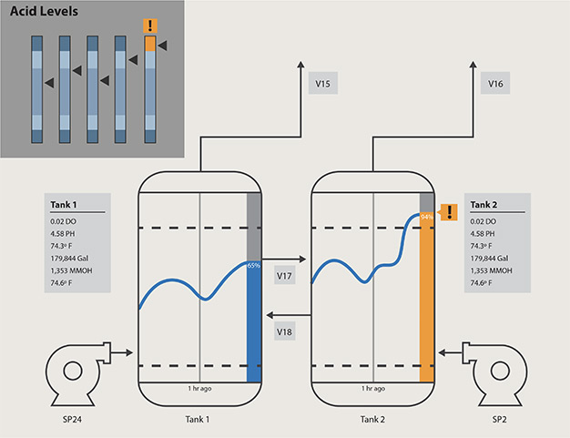

combine emphasis
Combine emphasis principles to create compelling HMI screens that optimize operator efficiency.
Rather than using these techniques on their own, it is recommended to combine techniques to create even greater emphasis. For example, the moving analog indicator shown in this paper used both color and position to display that a value had gone into an alarm state. The use of more than one emphasis technique to convey urgent information is called redundant coding.
By combining emphasis techniques, you can create a hierarchy of importance for each element on the screen. Check out other HMI examples and experiment with different combinations to find and create the desired effect. Remember that the goal of using emphasis in your HMI project is to make it a more effective tool in the hands of its operator.
