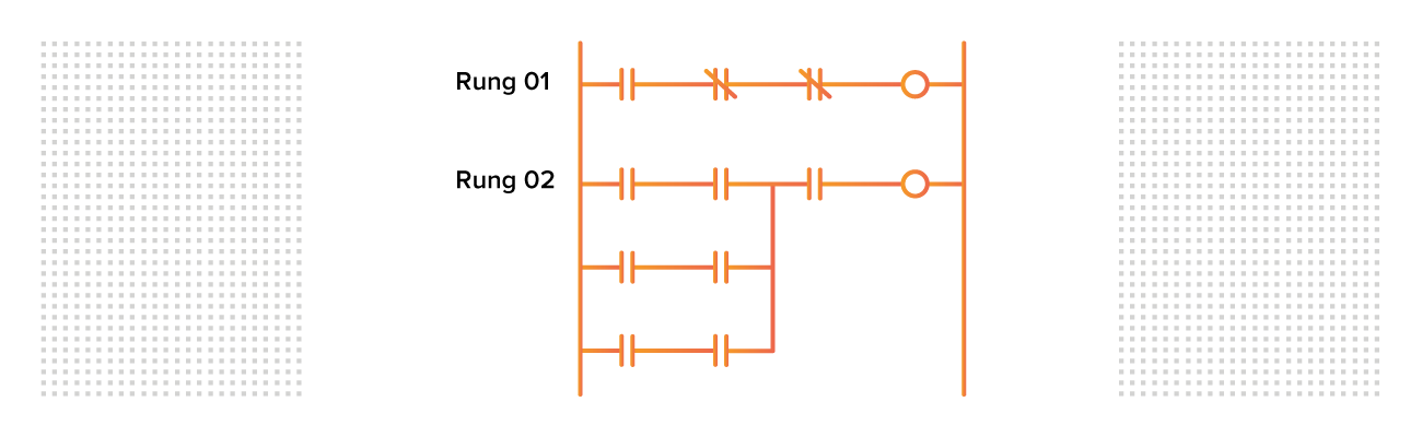

PLC Ladder Logic Example
Ladder Logic
Ladder Logic, also known as Ladder Diagram, is a graphical PLC programming language based on relay logic’s circuit diagrams. Ladder Logic consists of two parallel bars connected by a series of rungs, resembling a ladder in appearance (hence, the name). There are contacts and coils on these rungs, which symbolize inputs (such as a sensor value) and outputs (like a motor run command) respectively.
The vast majority of control system programming in North America uses Ladder Logic, and for good reason. It’s flexible, versatile, simple to troubleshoot, and easy to learn. One drawback, however, is that once a ladder hits a certain amount of rungs, it can become unwieldy and need to be split into multiple ladders for maintainability.
State machines, PID control, and systems with an abundance of Boolean algebra are some use cases that are well-suited for Ladder Logic.

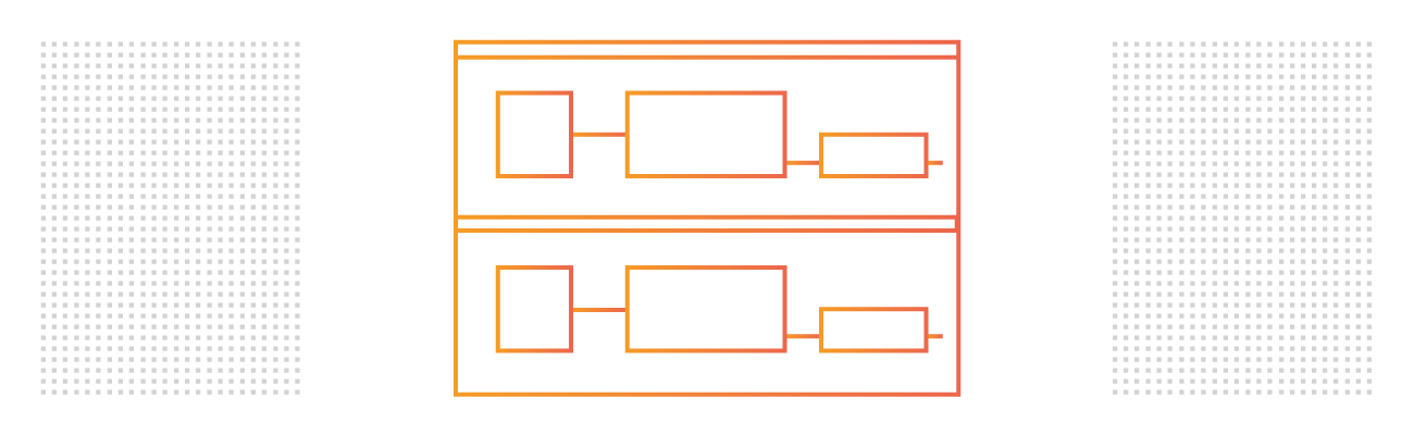

PLC Function Block Diagram Example
Function Block Diagram (FBD) is another popular graphical PLC programming language. It consists of various kinds of blocks that have inputs and outputs. Devices connected to the PLC can be linked to an input, and variables can be sent to an output. Additionally, blocks connect to each other — the output of one block can feed into another block’s input. These blocks are what define the functions of a system.
The FBD language is relatively simple, though it does require some training to use. It’s a great choice for safety PLCs, PID loops, and when you need to do encapsulation, reuse code frequently, hide or preserve data, or do analog input filtering.
